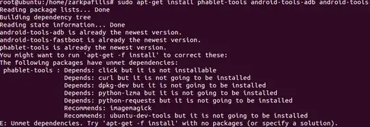

Occasionally, when I'm installing stuff, I get an error like the following:
Some packages could not be installed. This may mean that you have
requested an impossible situation or if you are using the unstable
distribution that some required packages have not yet been created
or been moved out of Incoming.
The following information may help to resolve the situation:
The following packages have unmet dependencies:
 package1 : Depends: package2 (>= 1.8) but 1.7.5-1ubuntu1 is to be installed
E: Unable to correct problems, you have held broken packages.
How can I resolve this?

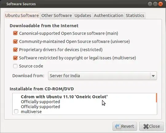

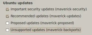

  • If the error shows something like this:
    <some-package>: Depends: <other-package> (= version) but this-version is to be installed

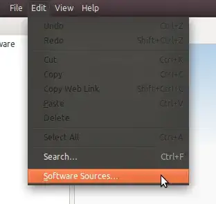

    Then make sure that the restricted and universe repositories are enabled. Hit Alt+F2, type software-properties-gtk and hit Enter.
    Under Ubuntu Software tab, enable all the repositories.

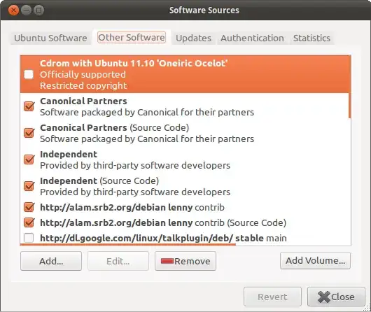

  • Disable:
    Disabling a PPA means no more updates for the packages installed from that PPA. To disable a PPA: Open Software Center > Edit > Software Sources Or,
    Hit Alt+F2 and run software-properties-gtk.
    Click on Other Software tab, you'll see that each PPA have two lines here, one for the compiled packages and one for the source, Uncheck both lines to disable a PPA. Here you can also add and remove PPAs.

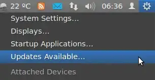

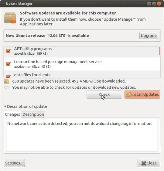

  • Keep Ubuntu Up to date. Ubuntu automatically notifies when updates are available, you can also check for available updates by clicking on Session Indicator in Unity panel:
    Or, Hit Alt+Ctrl+T to open terminal and run following commands:
    sudo apt-get update
    sudo apt-get upgrade
    Update: Synchronizes your list of available packages with the servers in source repositories. Upgrade: Downloads & installs any newer versions of your installed packages.

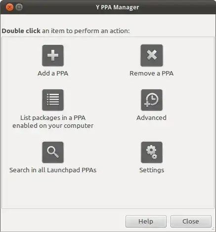

  • Remove duplicate PPAs. Y PPA Manager (installation guide at the end of answer) can easily scan and remove duplicate PPAs.

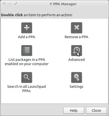

    • Hit Alt+F2 and run y-ppa-manager to open Y PPA Manager.
    • Once open, double click or hit Enter on Advanced.
    • In resulting window select Scan and remove duplicate PPAs and click OK.

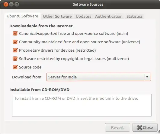

Checking if all required sources are enabled
Type gksu software-properties-gtk and you'll get this window
Make sure all sources are enabled.
next, go to the Other software tab and check if the required PPAs for the software to be installed are there and are enabled. Also, try disabling some PPAs which might be having broken packages
now, run sudo apt-get update
Try installing the software now

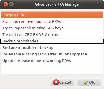

Y-PPA Manager
Y-PPA Manager is a gui app that helps you manage PPA's and various problems assosiated with it
To install it
sudo add-apt-repository ppa:webupd8team/y-ppa-manager
and
sudo apt-get update
and
sudo apt-get install y-ppa-manager
Considering the question, apt is broken so, use these command instead
sudo su
and
32 Bit:
mkdir y-ppa-manager && cd y-ppa-manager && wget https://launchpad.net/~webupd8team/+archive/y-ppa-manager/+files/launchpad-getkeys_0.3.2-1~webupd8~oneiric_all.deb && wget https://launchpad.net/~webupd8team/+archive/y-ppa-manager/+files/y-ppa-manager_0.0.8.6-1~webupd8~precise_all.deb && wget https://launchpad.net/~webupd8team/+archive/y-ppa-manager/+files/yad_0.17.1.1-1~webupd8~precise_i386.deb && dpkg -i ./*.deb
64 Bit:
mkdir y-ppa-manager && cd y-ppa-manager && wget https://launchpad.net/~webupd8team/+archive/y-ppa-manager/+files/launchpad-getkeys_0.3.2-1~webupd8~oneiric_all.deb && wget https://launchpad.net/~webupd8team/+archive/y-ppa-manager/+files/y-ppa-manager_0.0.8.6-1~webupd8~precise_all.deb && wget https://launchpad.net/~webupd8team/+archive/y-ppa-manager/+files/yad_0.17.1.1-1~webupd8~precise_amd64.deb && dpkg -i ./*.deb

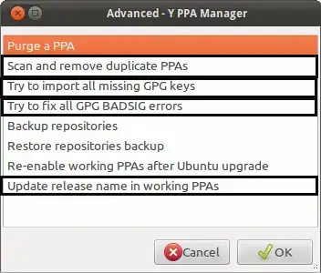

Now type in y-ppa-manager
You'll be presented with this window

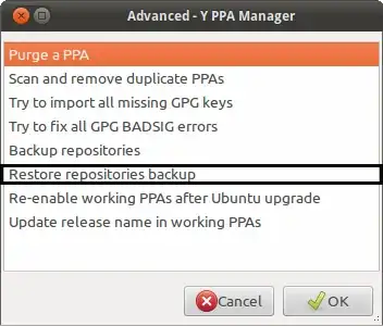

Double click on advanced, and you'll get this window
Do the following Tasks outlined in black

or, you can always use Update Manager with this command
gksu update-manager

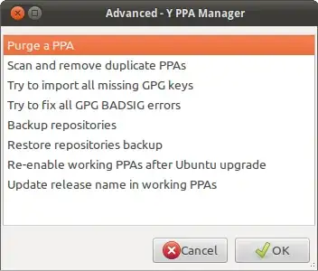

Run this command to open Y-PPA-Manager
y-ppa-manager

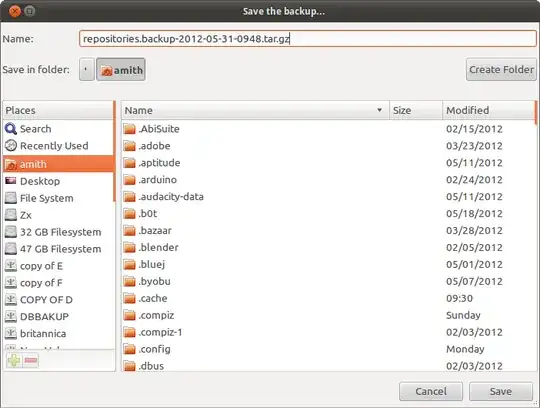

Run this:
You'll be asked to save a tar.gz file with a dialog similar to the one below. Save it in another partition or a safe place

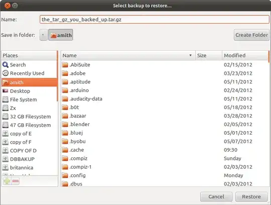

Later, when you need to restore it again, follow similar steps and when you get to the advanced dialog,Click on this:
You'll be asked to restore from the previous backup which you saved before with a dialog similar to the one below

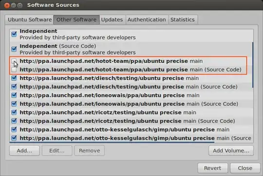

These methods need to be followed whenever you get eror regarding Unmet Dependencies
After following the instructions try installing the software. Atleast one of these methods should work for you
1. Before trying any new command or adding any new ppa try this
Cleaning up of the apt cache:
sudo apt-get clean
Cleaning up of any unused dependencies:
sudo apt-get autoremove
Updating apt-cache
sudo apt-get update
This will remove all the cache and will download a fresh cache. This should be done to get fresh cache packages and newer updates.
2. Try sudo apt-get install -f.
It will probably give some suggestions about removing and installing packages, do what seems reasonable.
3. Change the Download Server from Software Sources Because sometimes the files on a server are corrupted.
4. This also happens if you before added an external ppa for the broken dependency.Try removing that ppa by
  • either typing sudo add-apt-repository --remove ppa:someppa/ppa and then manually removing the ppa installed files/libraries
or
  • purging a ppa (this removes the installed files also)
    sudo apt-get install ppa-purge   #a one time install
    sudo ppa-purge ppa:someppa/ppa
5. If no 4 is not your case then atleast try to remove the package that is being shown as a broken dependency.Then try again installing.This is reported to have workeed for quite a few people.
6. Always add the stable version of a repository/PPA.
7 Also make sure you have all the official repositories enabled (In Software Sources)
Please do not enable the Proposed Updates as they are meant for testing/developers.

  1. Connect to the internet :D
  2. Make sure that all the default repositories are enabled
    ->You can easily add them in the Software Center->Edit->Software Sources->Other Sources->Add"
    -> Start the Software Center.
    ->. In the panel go to Edit and select Software Sources.
    edit-software-sources
    ->Make sure all the repositories are checked enter image description here
  3. Update the software catalog
    click on the top right icon and chose update-available Entry in the menu
and press check button enter image description here

This program disables a PPA from your Software Sources and reverts your system back to the official Ubuntu packages. You can use this to return your system to normal after testing a new version from a PPA.
Syntax
sudo ppa-purge ppa:<repository-name>/<subdirectory>
Example
sudo ppa-purge ppa:ubuntu-mozilla-daily/ppa

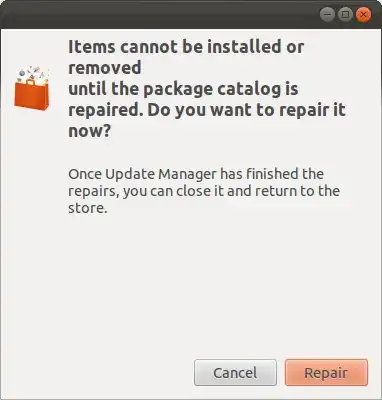

  1. open software center ,and try to install any software , If the following dialog box appeared ,press on the repair button ,and wait
Else type ctrl+alt+t to open terminal and type sudo apt-get install -f and follow the onscreen instructions
If still error occurs, Feel free to to ask it in askbuntu

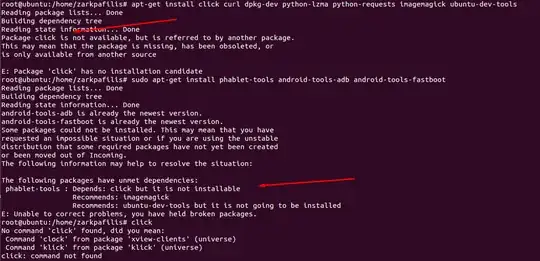

If you are getting an error like this:
This is telling you that the packages are already installed, but it has not installed all of the other packages it needs to work. You should be able to solve this by running this:
sudo apt-get -f install
(This command should automatically install the unmet dependencies.)
or something like this (with the relevant packages):
sudo apt-get install click curl dpkg-dev python-lzma python-requests imagemagick ubuntu-dev-tools
But if you end up with this sort of error: cannot install package/package not available/no installation candidate etc
You can then search for ways to install them here or here.
With the above example, you should be able to find a page like this, and then use a PPA, or install a .deb for 32bit, or a .deb for 64bit.
