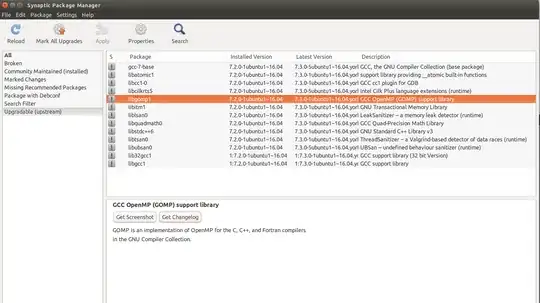

Running Synaptic, here's a list of suspicious packages:
upgradeable packages in Synaptic
