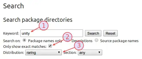

First, check if the package actually does exist:
  1. Go to packages.ubuntu.com with a web browser.
  2. Scroll down to "Search package directories"
  3. Enter the package which you're trying to install into the "Keyword" field.
    Enable "Only show exact matches:"
    Change the "Distribution" to the codename of the version of Ubuntu you're using, e.g. focal in Ubuntu 20.04 or it's displayed by lsb_release -sc
    Search package direction. Keyword search box: "unity", with buttons for "Search" and "Reset". Followed by options for "Search on", with "Package names only" selected (with "descriptions" and "Source package names" being the other options). A checkbox for "Only show exact matches" is ticked. A "distribution" dropdown has "raring" selected, and a "section" dropdown is set to "any".
If there are no results, the package you are looking for doesn't exist and the next steps will not work. It may require a third party PPA or an alternative installation method.
If results are found, the package exists and you may continue with these steps:

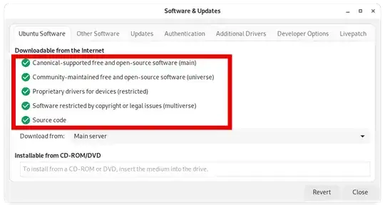

  1. Open Software Sources (or Software & Updates in 13.04+) by searching for it in the Dash.
  2. Open the "Ubuntu Software" tab.
  3. Ensure that the first 4 checkboxes on this tab are enabled:
Software & Updates panel, on the "Ubuntu Software" tab. There are five options in "Downloadable from the internet", all selected: Canonical-supported free and open-source software (main); Community-maintained free and open-source software (universe); Proprietary drivers for devices (restricted); Software restricted by copyright or legal issues (multiverse); Source code. A "Download from" dropdown is set to "Main server".
  1. Update the package lists, then test with these commands:
