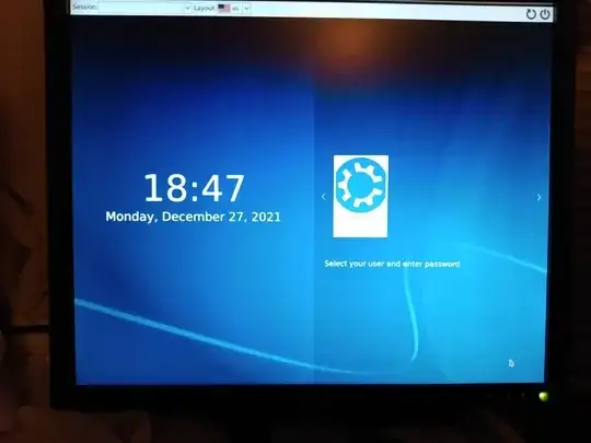

I was trying to compile a hello world c file. I tried to apt-get install build_essentials but it said it couldn't because of g++ perhaps it was g++6. I then told it to install that and it complained about something else. Eventually it said it would have to downgrade something for me to install and I said go ahead. I think it might have been libc. I went through with it but then after I reboot the computer the kde login screen is unfamiliar and doesn't work. It is blue with I can still switch desktops to a console and log in.
I believe the ubuntu version is Ubuntu 20.04.3 LTS. (or at least was before the command lol)
What is the recommended set of actions to get the system back up and running. It is ok of gcc doesn't work. I have other computers. Is there a simple set of apt-get commands which will remove the stupid downgrade I put in and put things back to where they were? I can confirm this and other things.

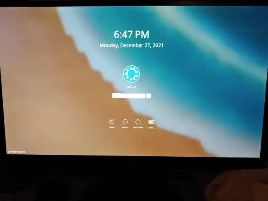

Here is what the login screen should look like: enter image description here
And this is what the login screen does look like: enter image description here

Could fix the desktop. kubuntu-desktop is a meta package for KDE.
It is from previous experience. Usually, two issues may cause such results with login screen.
  • Default Display Manager DM removed or replaced with newly installed, due a conflict between packages (Unmet dependency with some base libraries) or new Desktop Environment DE was installed.
  • Or an issue with DM itself or its settings.
BTW, it was first case, I would recommend trying aptitude when having unmet dependencies and flip over provided solutions, not all get to downgrade or remove many packages.
