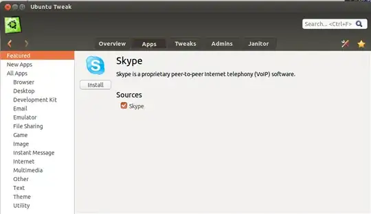

I'm New. Try install UBUNTU TWEAK.
Hope it help.
