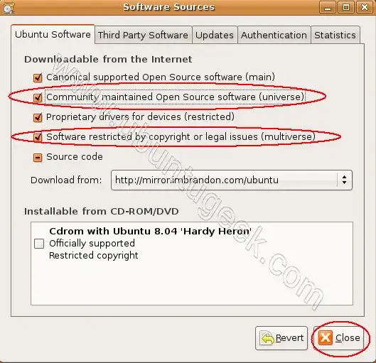

VLC is there in the Ubuntu Repos as well. You can install it after enabling universe Repo. This should be automatically enabled for you when you Install Ubuntu and select install 3rd party software and install Updates while Installing.
If you missed it during Install you can enble unniverse repository by Opening Software and Sources and select the repositories as shown in the picture.
Enabling Universe and Multiverse Repos

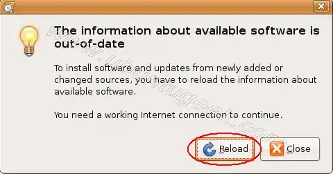

After hiting close you get option to reload the Cache.
Reload Software cache
Once that is done you should see VLC in software Center or you may install it via command line.
There is no need for adding any third party repo unless you can't find what you want in the official repo or you want the latest and greatest.
PPA's can sometimes break your system because of library mismatch. Alway USE PPA's with caution.
