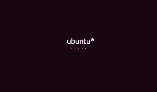

After the restart when I went to ubuntu it got stuck in the startup itself
