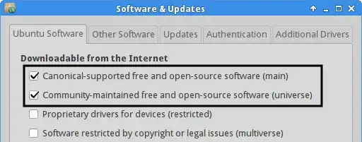

Package alien & build-essential are avilable on main repository for Ubuntu 14.04.
First of all make sure that you have enabled Main & Universe Repository from Software & Updates:
The main component contains applications that are free software, can be freely redistributed and are fully supported by the Ubuntu team. & The universe component is a snapshot of the free, open-source, and Linux world.
