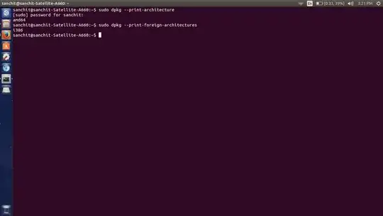

  1. This one suggests sudo dpkg --add-architecture i386. But it was not useful. enter image description here

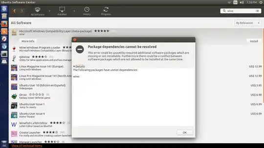

Ubuntu Software Centre:
