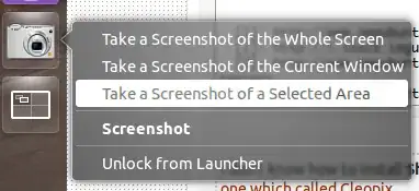

And after that make that file executable, using chmod +x screenshot.desktop. And it is ready for use! Just add it to your unity launcher and that's all:
That's how it will look like!
