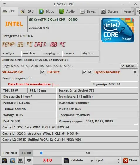

You need to add libcpuid11 and Gambas Stable Builds PPA's to your system
add libcpuid11 PPA by running this command
sudo add-apt-repository ppa:i-nex-development-team/libcpuid11
add Gambas Stable Builds PPA by running this command
sudo add-apt-repository ppa:gambas-team/gambas3
Then install i-nex
sudo apt-get install i-nex
if it shows this output at the end of the install
Errors were encountered while processing:
 i-nex
E: Sub-process /usr/bin/dpkg returned an error code (1)
delete the install script. Run this command
sudo rm /var/lib/dpkg/info/i-nex.postinst
and run the install command again
sudo apt-get install -f
then run i-nex
i-nex
