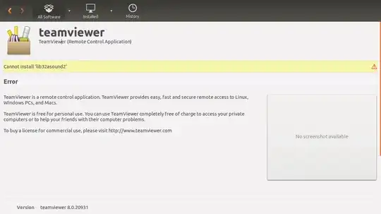

UPDATE:
I tried to install teamviewer and got similar error:
