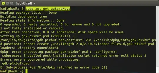

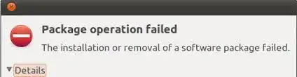

I can not install and uninstall software I used these comments:
sudo dpkg --configure -a
sudo apt-get clean
sudo apt-get update
sudo apt-get update
sudo dpkg-reconfigure -a
What shall I do ?
Pictures of my errors:
sudo apt-get clean
sudo apt-get update
sudo apt-get update
What shall I do ?
Package gdk-pixbuf-psd wants to put a file in directory /usr/lib/gtk-2.0/2.10.0/loader-files.d but there is no such directory.
I suggest you create it with the command sudo mkdir -p /usr/lib/gtk-2.0/2.10.0/loader-files.d and then try sudo apt-get autoremove again.
If this fixes your problem please consider filing a bug report for that package.
