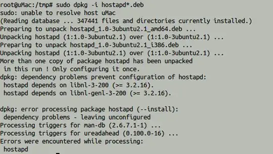

All the time I gets this dependency issue when trying installing hostapd as mentioned here
Ubuntu version 14.04 Arch 64
