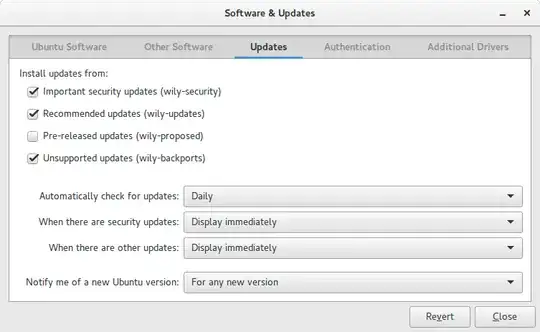

Earlier you had enabled trusty-updates, this channel contains the version 2.5.3.1-1ubuntu2.2 for both packages. You could also re-enable trusty-updates.
Open Software & Updates and the tab Updates and activate trusty-updates as you can see in the screenshot (ok, it's a Wily screenshot and not Trusty).
