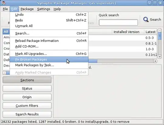

You need to install "Synaptic Package Manager(click here to know how to install it)"
After installing that software, do as shown in image below
open the software, click on "edit", then click "fix broken packages", then click "Apply" (which you will find it below menu bar)- After this click on this link to know how to install wine 1.7. Follow the method properly, you be fine
Done !
