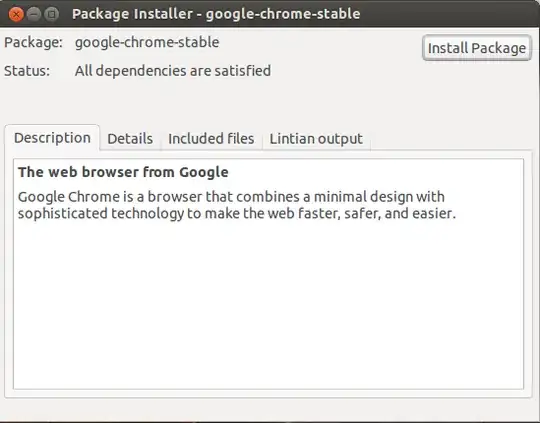

My favourite is GDebi, available from both terminal/shell or graphical desktop.
screen-shot
I usually associate .deb files with GDebi as it is fast and efficient - especially compared to Ubuntu Software Center. One of the main feature of GDebi is it resolves dependencies and installs them.
For command-line run sudo gdebi <package.deb> to install a single deb file.
