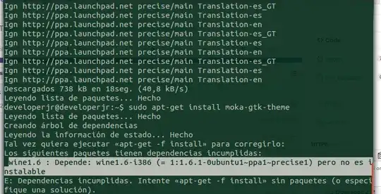

I marked the problem i cant install with ubuntu center and Synaptic i cant repair !!
The following packages have unmet dependencies: wine1.6: Depends: wine1.6-i386 (= 1: 1.6.1-0ubuntu1 PPA1 ~ ~ precise1) but it is not installable E: Unmet dependencies. Try 'apt-get f install' with no packages (or specify a solution).
64 bit 12.04LTS
and tried update to ubuntu 14.04 but I cant update too..
Since I can't read Spanish (I guess) and since you tagged wine, then probably you didn't follow the correct procedures to install wine from PPA.
To install wine from command line:
1- Open a terminal and add the wine Ubunutu PPA (Personal Package Archive) by typing
sudo add-apt-repository ppa:ubuntu-wine/ppa
2- Then, perform an update to the list of archives by typing sudo apt-get update
3- Wine should now be in the list, install it by typing: sudo apt-get install wine1.7
Note: wine1.7 is the latest version, I use 1.6 version. you can choose your wine version before installing by pressing Tab after typing sudo apt-get install wine

First of all close the terminal, Ubuntu Software Centre & Synaptics. Now open a terminal and try these steps:
sudo apt-get purge moka-gtk-theme wine1.6
sudo apt-get autoremove
sudo apt-get autoclean
sudo apt-get update
sudo apt-get install wine1.6
sudo apt-get install moka-gtk-theme
Post any error you get in any of the command.
