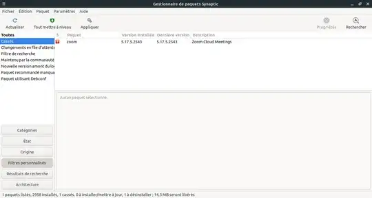

Installing zoom-meeting created a broken package. Since then I've tried everything, but nothing can be done.
Package Manager screenshot

sudo dpkg **--purge** zoom Solved the problem after making sudo apt update sudo apt upgrade
