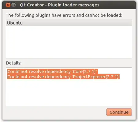

(In Ubuntu 13.10) Ubuntu-SDK opens with the following errors:
Does anyone know how to resolve these dependencies?
I had had the same problem, but I solved it removing all the extras repositories that I had added to install ubuntu-sdk and removing my previus version of qt-creator and all the others stuff that I had installed trying to solve this problem.
After get the results of the commands:
apt-cache search ubuntu-sdk
and
dpkg -l | grep ubuntu-sdk
equals to zero.
I added the ppa repository and install the ubuntu SDK again:
sudo add-apt-repository ppa:ubuntu-sdk-team/ppa
sudo apt-get update && sudo apt-get install ubuntu-sdk
After that the ubuntu SDK started to work ok for me.
