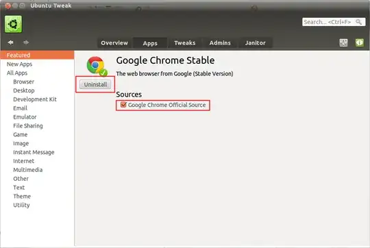

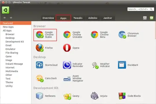

Just install Ubuntu Tweak and under the apps tab, you will find a link to install Google Chrome directly.
EDIT
Check images below:
Though now in your case, you will have to check the checkbox and then click install.
Hope it works out.
