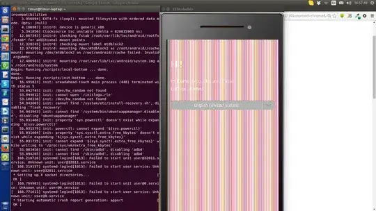

So my next step was to install ubuntu-emulator to see how Ubuntu Touch looks like at least. After emulator installation and instance creation I get the following:
A little excerption from terminal:
[    3.332876] EXT4-fs (mmcblk0): couldn't mount as ext3 due to feature incompatibilities
[    3.352482] EXT4-fs (mmcblk0): couldn't mount as ext2 due to feature incompatibilities
                                                                            [    3.396557] EXT4-fs (mmcblk0): mounted filesystem with ordered data mode. Opts: discard
                                                                                                            [    3.437316] initrd: boot mode: normal
                                                                                                                           [    3.510130] EXT4-fs (loop0): couldn't mount as ext3 due to feature incompatibilities
[    3.522541] EXT4-fs (loop0): couldn't mount as ext2 due to feature incompatibilities
                                                                                                                                                                                                        [    3.688075] EXT4-fs (loop0): mounted filesystem with ordered data mode. Opts: (null)
[    3.691622] initrd: mounting system.img (image developer mode)
[    3.822189] EXT4-fs (loop1): couldn't mount as ext3 due to feature incompatibilities
[    3.844501] EXT4-fs (loop1): couldn't mount as ext2 due to feature incompatibilities
                                                                             [    3.956694] EXT4-fs (loop1): mounted filesystem with ordered data mode. Opts: (null)
[    4.106987] initrd: device is generic_x86
               [    5.341856] Clocksource tsc unstable (delta = 820035903 ns)
[   12.067393] initrd: checking fstab /root/var/lib/lxc/android/rootfs/fstab* for additional mount points
                                                                       [   12.328245] initrd: checking mount label mtdblock2
                                                                                      [   12.374596] initrd: mounting /dev/mtdblock2 as /root/android//cache
mount: mounting /dev/mtdblock2 on /root/android//cache failed: Invalid argument
[   12.406983] initrd: mounting /root/var/lib/lxc/android/system.img as /root/android/system
                                                                                                                                                                                                                                                                            Begin: Running /scripts/local-bottom ... done.
done.
Begin: Running /scripts/init-bottom ... done.
[   16.495823] init: ureadahead-touch main process (448) terminated with status 5
[   53.042745] init: /dev/hw_random not found
               [   53.044612] init: cannot open '/initlogo.rle'
[   53.188136] init: /dev/hw_random not found
               [   54.943603] init: cannot find '/system/etc/install-recovery.sh', disabling 'flash_recovery'
[   54.943943] init: cannot find '/system/bin/ubuntuappmanager.disabled', disabling 'ubuntuappmanager'
[   55.031468] init: property 'sys.powerctl' doesn't exist while expanding '${sys.powerctl}'
[   55.031579] init: powerctl: cannot expand '${sys.powerctl}'
[   55.031664] init: property 'sys.sysctl.extra_free_kbytes' doesn't exist while expanding '${sys.sysctl.extra_free_kbytes}'
[   55.031735] init: cannot expand '${sys.sysctl.extra_free_kbytes}' while writing to '/proc/sys/vm/extra_free_kbytes'
[   55.083456] init: cannot find '/sbin/adbd', disabling 'adbd'
[   55.094205] init: cannot find '/sbin/adbd', disabling 'adbd'
[  166.218726] systemd-logind[1013]: Failed to start unit user@32011.service: Unknown unit: user@32011.service
                                                                                                      [  166.219137] systemd-logind[1013]: Failed to start user service: Unknown unit: user@32011.service
                                                                                                                                                                                                 * Setting up X socket directories...                                [ OK ]
[  168.769983] systemd-logind[1013]: Failed to start unit user@0.service: Unknown unit: user@0.service
                                                                                              [  168.771611] systemd-logind[1013]: Failed to start user service: Unknown unit: user@0.service
                                                                                                                                                                                     * Starting automatic crash report generation: apport                [ OK ]
                                                                                                                                                                                     emulator: User configuration saved to /home/timur/.android/emulator-user.ini
The emulator is very slow (I work on my HP laptop) and buggy. I assume that the reason of buggy view is in video drivers and may be something relating with OpenGL, I don't know... I will create an additional question regarding this issue
