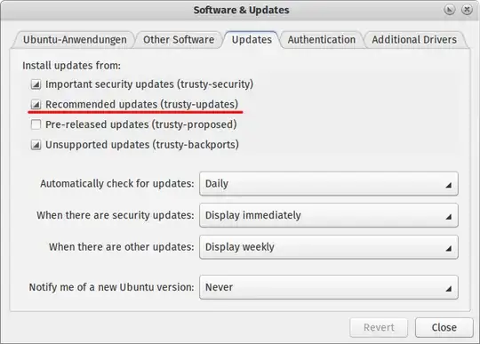

  1. Enable the "updates" repository.
    Open Software Properties, navigate to the Updates tab and enable the checkbox for Recommended updates.
    software properties screenshot
  2. Update the package list and perform a system upgrade:
    sudo apt update && sudo apt full-upgrade
