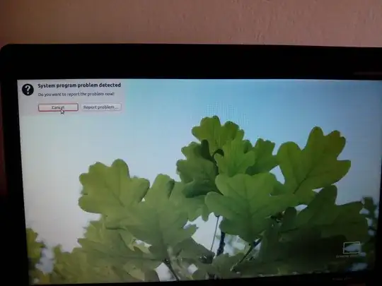

After this on log screen I have choice between Unity and Gnome desktop enviroment. Gnome works fine but when I have rebooted machine and loged in a Unity session there was a "mixed Unity". It was Unity with Gnome font, Gnome dialogs and a Gnome look terminal window. Also when I boot machine there is a blue GRUB screen instead of ubuntu purple one. I have tried to restore Unity sudo apt-get install unity but nothing was installed ("...there is latest version..."). Lastly I decided to remove Gnome and tried (from here):

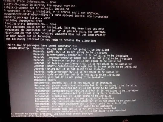

I also tried to install libgtk-3-common but
libgtk-3-common is already the newest version
libgtk-3-common set to manually installed
And tried to sudo apt-get install ubuntu-desktop
I have solved this unmet dependencies by:
sudo cp /etc/apt/sources.list /etc/apt/sources.list.original
sudo cp /var/lib/dpkg/status /var/lib/dpkg/status.original
apt-get autoclean
apt-get autoremove
sudo apt-get -f install
and then sudo apt-get install --reinstall ubuntu-desktop works and now I can normally boot a Gnome session but Unity still have some problems. There is no launcher, upper line...
