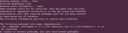

I am trying to install the latest version of vim on Ubuntu 12.10. But when I use this command
sudo apt-get install vim
It gives me such an error enter image description here
How to solve this?

Have you tried running sudo apt-get install vim-common before sudo apt-get install vim? It looks like it's just missing that dependency; once that's installed I imagine it should work alright.

Just press Ctrl+Alt+T on your keyboard to open Terminal. When it opens, run the command(s) below:
sudo apt-get -f install
Once that command finishes, then do
If the above doesn't work, try
sudo apt-get clean
Then
sudo apt-get update && sudo apt-get upgrade
and try installing VIM again.
Try installing GUI VIM
sudo apt-get install vim-gnome

You can try this :
sudo dpkg --configure -a
and then
sudo apt-get install -f
Then, you may need to retry to install vim
