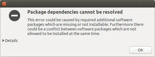

When I tried to install the required multimedia plugins in the Ubuntu Software Center this error message appeared.
This error could be caused by required additional software packages which are missing or not installable. Furthermore there could be a conflict between software packages which are not allowed to be installed at the same time.
