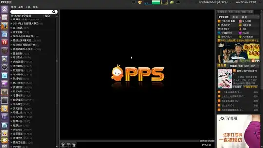

The following deb file seem to work, ignore the error and you should be good to go
wget https://launchpadlibrarian.net/58988381/ppstream_1.0.0-3lucid2_amd64.deb
sudo dpkg -i ppstream_1.0.0-3lucid2_amd64.deb
screenshot: enter image description here
