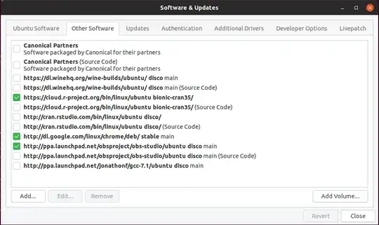

Through Software & Updates -> Other Software, I unticked a couple of items which I may have helped or worsened stuff:
Software & Updates
I hope I have included anything which may be helpful. Let me know if you need more detail.

This is a simple fix. bionic-cran35 is trying to run as it is present in the source.list. This is from a previous botched attempt at installing. Commenting out the
deb https://cloud.r-project.org/bin/linux/ubuntu bionic-cran35/
line in the code has fixed this ptoblem.
Bionic is from previous Ubuntu distributions and has been replaced by Disco in 19.04.
Thank you to @steeldriver for pointing out my flaw.
