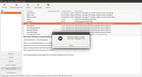

But these packages cannot be uninstalled. I have also tried answers given to How do I resolve unmet dependencies after adding a PPA? and this one but it has not resolved anything.
I have also tried using Aptitude, but the problem is still the same.
I also tried with Synaptic package manager. it is also unable to resolve the dependencies.
could not apply changes, fix broken packages first
