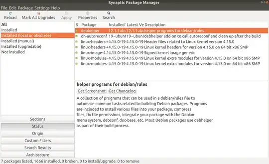

Compare now between these two lists:
  1. Synaptic → SideBar:Status → Installed (local & obsolete)
    Synaptic - local & obsolete packages
  2. aptitude search '~o'
    user@user-vb:~$ aptitude search '~o'
    i A linux-headers-4.15.0-19                          - Header files related to Linux kernel version 4.15.0
    i A linux-headers-4.15.0-19-generic                  - Linux kernel headers for version 4.15.0 on 64 bit x86 SMP
    i A linux-image-4.15.0-19-generic                    - Signed kernel image generic
    i A linux-modules-4.15.0-19-generic                  - Linux kernel extra modules for version 4.15.0 on 64 bit x86
    i A linux-modules-extra-4.15.0-19-generic            - Linux kernel extra modules for version 4.15.0 on 64 bit x86
    user@user-vb:~$
