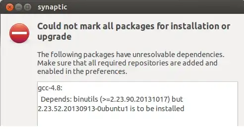

When I try to install gcc-4.8 from Synaptic It wants to remove g++-4.8 and when I tell that it is ok to remove it, I get this error:
How can I install gcc-4.8.2 and g++-4.8.2?

gcc 4.8.2 is currently under development and will only be released for trusty(14.04LTS).
The current latest version available for Ubuntu 13.10 saucy is 4.8.1 and it will not be updated to 4.8.2
You are getting this message as you have broken packages in your system. To be sure try this in your terminal,
dpkg -l | grep "^rc" | awk '{print $2}'
You should get a list showing above packages.
Run the following in a terminal to get rid of this,
sudo apt-get autoremove
sudo apt-get autoclean
To install gcc-4.8 and g++-4.8
sudo apt-get update
sudo apt-get install gcc-4.8 g++-4.8
