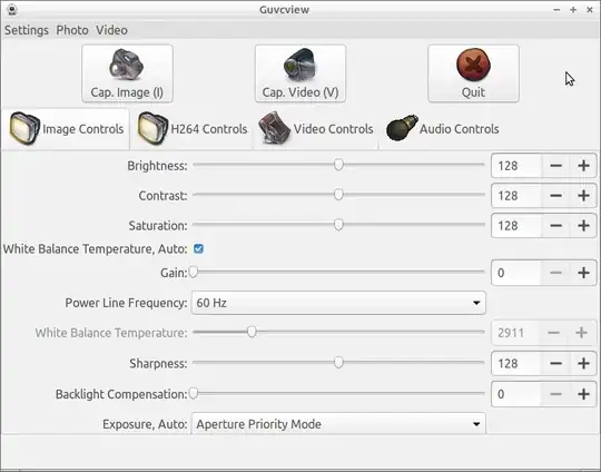

Everything works now. guvcview is working again too, which is nice, because I broke it while debugging this error.
guvcview welcome back
