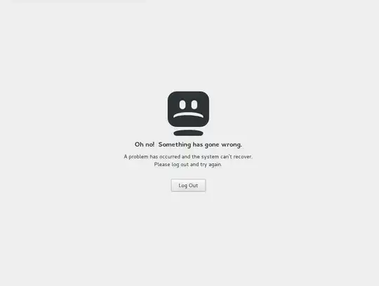

I use a Dell Latitude E6520 laptop with Ubuntu 20.04.
I booted my laptop as usual and was greeted with a "Oh no! Something has gone wrong." message that told me to log out.
When I clicked OK, the system crashed and ever since then it boots to a black screen with a white underscore at the top (not blinking).

After the re-install, there also appeared a new error message:
error message
Thoughts?
