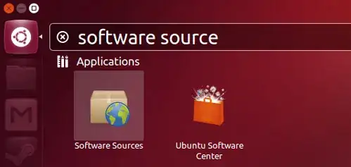

Installing Spotify
The first step is to open Software Sources via the Unity Dash:

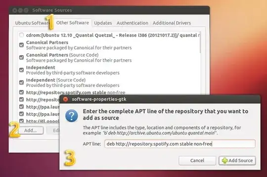

Select the ‘Other Software’ tab in Software Sources 1
Click ‘Add’ 2 and paste the following the entry field of the box that appears:
  deb http://repository.spotify.com stable non-free
Click ‘Add Source’ to confirm the change, then close Software Sources.
