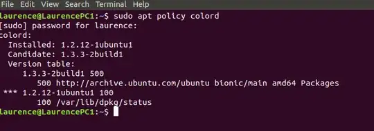

The result from apt policy colord is as follows:

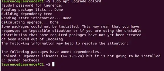

Result of sudo apt upgrade colord
result of sudo apt upgrade colord

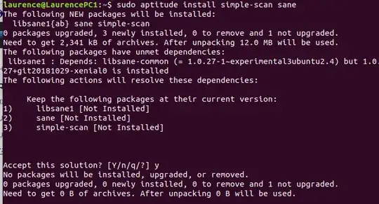

Results after attempting to install simple-scan sane:
Results for apt-cache policy libsane-common:
Laurence@LaurencePC1:~$ apt-cache policy libsane-common
libsane-common:
  Installed: 1.0.27+git20181029-xenial0
  Candidate: 1.0.27+git20181029-xenial0
  Version table:
 *** 1.0.27+git20181029-xenial0 100
        100 /var/lib/dpkg/status
     1.0.27-1~experimental3ubuntu2.4 500
        500 http://archive.ubuntu.com/ubuntu bionic-updates/main amd64 Packages
        500 http://archive.ubuntu.com/ubuntu bionic-updates/main i386 Packages
     1.0.27-1~experimental3ubuntu2.3 500
        500 http://archive.ubuntu.com/ubuntu bionic-security/main amd64 Packages
        500 http://archive.ubuntu.com/ubuntu bionic-security/main i386 Packages
     1.0.27-1~experimental3ubuntu2 500
        500 http://archive.ubuntu.com/ubuntu bionic/main amd64 Packages
        500 http://archive.ubuntu.com/ubuntu bionic/main i386 Packages
Results for: sudo apt install --reinstall libsane-common=1.0.27-1~experimental3ubuntu2.4
[there is an error]
laurence@LaurencePC1:~$ sudo apt install --reinstall libsane-common=1.0.27-1~experimental3ubuntu2.4
[sudo] password for laurence:
Reading package lists... Done
Building dependency tree
The following additional packages will be installed:
  colord libsane1
Suggested packages:
  colord-sensor-argyll hplip
Recommended packages:
  sane-utils
The following packages will be REMOVED
  libsane sane-utils
The following NEW packages will be installed
  libsane1
The following packages will be upgraded:
  colord
The following packages will be DOWNGRADED:
  libsane-common
1 to upgrade, 1 to newly install, 1 to downgrade, 2 to remove and 0 not to upgrade.
Need to get 2,556 kB of archives.
After this operation, 4,458 kB disk space will be freed.
Do you want to continue? [Y/n] y
Get:1 http://archive.ubuntu.com/ubuntu bionic-updates/main amd64 libsane1 amd64 1.0.27-1~experimental3ubuntu2.4 [2,088 kB]
Get:2 http://archive.ubuntu.com/ubuntu bionic-updates/main amd64 libsane-common all 1.0.27-1~experimental3ubuntu2.4 [273 kB]
Get:3 http://archive.ubuntu.com/ubuntu bionic/main amd64 colord amd64 1.3.3-2build1 [196 kB]
Fetched 2,556 kB in 2s (1,245 kB/s)
(Reading database ... 319188 files and directories currently installed.)
Removing sane-utils (1.0.27+git20181029-xenial0) ...
Selecting previously unselected package libsane1:amd64.
(Reading database ... 319176 files and directories currently installed.)
Preparing to unpack .../libsane1_1.0.27-1~experimental3ubuntu2.4_amd64.deb ...
Unpacking libsane1:amd64 (1.0.27-1~experimental3ubuntu2.4) ...
dpkg: error processing archive /var/cache/apt/archives/libsane1_1.0.27-1~experimental3ubuntu2.4_amd64.deb (--unpack):
 trying to overwrite '/usr/lib/x86_64-linux-gnu/libsane.so.1.0.27', which is also in package libsane:amd64 1.0.27+git20181029-xenial0
dpkg-deb: error: paste subprocess was killed by signal (Broken pipe)
Errors were encountered while processing:
E: Sub-process /usr/bin/dpkg returned an error code (1)
laurence@LaurencePC1:~$ sudo apt update && sudo apt -f install
Hit:1 http://dl.google.com/linux/chrome/deb stable InRelease
Hit:2 http://archive.ubuntu.com/ubuntu bionic InRelease
Hit:3 http://archive.canonical.com/ubuntu xenial InRelease
Hit:4 http://ppa.launchpad.net/eosrei/fonts/ubuntu bionic InRelease
Get:5 http://archive.ubuntu.com/ubuntu bionic-updates InRelease [88.7 kB]
Hit:6 http://activsoftware.co.uk/linux/repos/ubuntu bionic InRelease
Hit:7 http://ppa.launchpad.net/keymanapp/keyman/ubuntu bionic InRelease
Hit:8 http://activsoftware.co.uk/linux/repos/driver/ubuntu bionic InRelease
Get:9 http://archive.ubuntu.com/ubuntu bionic-backports InRelease [74.6 kB]
Get:10 http://archive.ubuntu.com/ubuntu bionic-security InRelease [88.7 kB]
Hit:11 https://repo.skype.com/deb stable InRelease
Get:12 http://archive.ubuntu.com/ubuntu bionic-updates/main amd64 DEP-11 Metadata [294 kB]
Get:13 http://archive.ubuntu.com/ubuntu bionic-updates/universe amd64 DEP-11 Metadata [288 kB]
Get:14 http://archive.ubuntu.com/ubuntu bionic-updates/multiverse amd64 DEP-11 Metadata [2,468 B]
Get:15 http://archive.ubuntu.com/ubuntu bionic-backports/universe amd64 DEP-11 Metadata [9,288 B]
Get:16 http://archive.ubuntu.com/ubuntu bionic-security/main amd64 DEP-11 Metadata [49.0 kB]
Get:17 http://archive.ubuntu.com/ubuntu bionic-security/universe amd64 DEP-11 Metadata [59.5 kB]
Get:18 http://archive.ubuntu.com/ubuntu bionic-security/multiverse amd64 DEP-11 Metadata [2,464 B]
Fetched 958 kB in 3s (325 kB/s)
1 package can be upgraded. Run 'apt list --upgradable' to see it.
N: Skipping acquire of configured file 'non-oss/binary-i386/Packages' as repository 'http://activsoftware.co.uk/linux/repos/ubuntu bionic InRelease' doesn't support architecture 'i386'
0 to upgrade, 0 to newly install, 0 to remove and 1 not to upgrade.
laurence@LaurencePC1:~$ sudo apt autoremove --purge
laurence@LaurencePC1:~$ sudo apt full-upgrade
Calculating upgrade... Done
The following packages have been kept back:
  colord
Personally, I don't see any problem with getting rid of the desktop during an upgrade. Most likely, a completely new desktop will come with the new release, and you must get rid of the old one to get the new one in place. Anyways, there's always a risk that comes with an upgrade, and you might end up screwing up your desktop if the upgrade does not finish successfully, but I'd say that is a fair risk to take. You always want to backup your OS before carrying on a system upgrade, so in case things go bad, you have a backup image to restore the system to.
I suggest that instead of doing the upgrade routine from a regular desktop session, you press Ctrl + Alt + F2 (or F3) to start a non-graphical session, and then carry on with the upgrade from there. That might reduce the risk of screwing up your upgrade if the graphical session crashes.
pip1726
  • 171
this will downgrade the package.
Then remove no longer required packages
the update your bionic
then try again.
