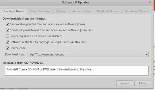

Try to add the source code repository and software restricted by copyright legal issues, as seen in this image:
Then, run a package cache update with this command:
sudo apt-get update
After updating, search your plugin package by running:
sudo apt-cache search vlc-plugin-libde265
