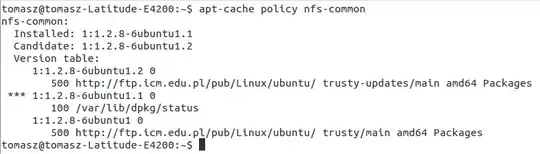

OK, I'm happy to force a previous version of nfs-common. This would match another machine that was setup months ago, presumably before the latest version was available. Going to that machine and running apt-cache policy nfs-common, I see it has installed 1:1.2.8-6ubuntu1.1. Looking at man pages for it and:

Here you can download the package in .deb . Another solution is to install through apt-get the closest lower version, which is available, ie. 1:1.2.8-6ubuntu1.1 if that would do.
EDIT 1
It installs easily too, at least from 1:1.2.8-6ubuntu1.1 up in case it doesn't.
EDIT 2
But you need to check yourself if it works alright. You will anyhow :-).
