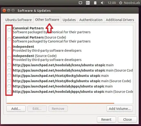

First run these commands in terminal (press Ctrl+Alt+T):
  • sudo apt-get --fix-broken install
  • sudo apt-get clean
  • sudo apt-get autoclean
  • sudo apt-get autoremove
  • sudo dpkg --configure -a
  • sudo apt-get update then following
1.Changed software and updates to main server
2.unmarked all "other software" sources
ims
3.reload it and run for software update.
4.Install samba : sudo apt-get install samba
