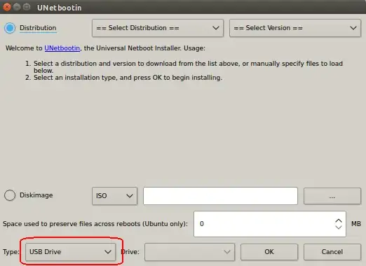

  • You know how to burn a LiveCD, LiveDVD or LiveUSB from within Windows 8. If not, look for Windows apps that can do that for you. I do mine in another PC with Ubuntu ^^.

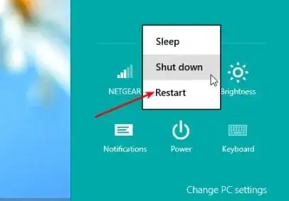

(This is a really old trick on most Windows, even since Windows 3.1 where you hold a key to do something special when rebooting)

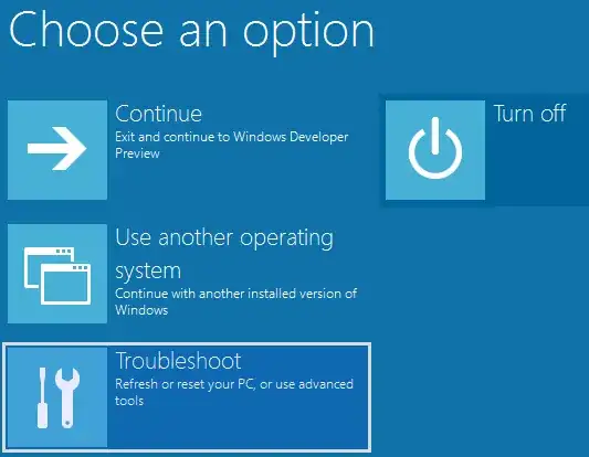

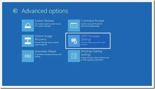

Windows 8 will show you a totally different restart window:
When you get the menu above, select Troubleshoot
You will then get the following options:
Select UEFI Firmware Settings
NOTE - In the Spanish version of Windows 8, the option for UEFI Firmware Settings is not available in several laptops, tested Lenovo, HP, and Acer. They do have an option to boot the computer and another custom menu will appear which lets you do a couple of things. In the case of Lenovo, you will not have an option to install Ubuntu with Windows 8, the only option is to remove Windows 8 completely. This only applies if you are not using 15.04+.

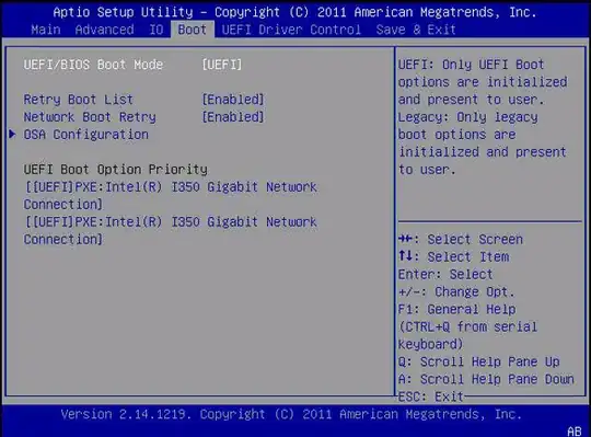

Now before saving, some motherboards offer a Boot Mode option. Verify that this option is not pointing to UEFI Boot but instead to CSM Boot (Compatibility Support Module) which provides support for Legacy BIOS like systems.
Other systems offer a UEFI Boot option you can enable or disable. Depending on the options I mentioned above you can set this to the one you want.
And lastly, others offer a UEFI/Legacy Boot First option where you select which one you wish to use first. Obviously, the option is self-explanatory.

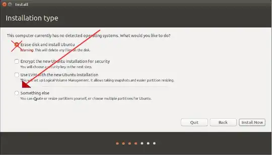

If you have followed all the steps above including making a partition ahead of time through Windows 8.x, proceed with the normal Ubuntu installation. When you arrive at the option to how you would like to install it if you do not see the option to install Alongside it, select "Something Else" instead of wiping the hard drive. Configure the new partition layout on the empty space you've set aside that isn't Windows 8 / 10.
You need to create at least 1 partition for the root system (Which shows as the symbol "/") and set it to Ext4, another for SWAP (Virtual Memory). The SWAP space can be as small as 128MB if you have a lot of ram or as high as 4GB. With this 2 partitions created based on the empty space you provided you should be ready to proceed. And one last one for the EFI part which should be around 100MB.
When the installer asks where to put the bootloader, tell it to put it on the partition with the type "efi". This will install GRUB which will load once your system starts in the future which will give you the choice of going with Ubuntu (or whatever flavor is installed) or going to the Windows Boot Manager which will take you to Windows 8.

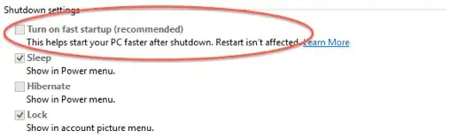

    This is most likely the cause of an option in Windows 8 called Fast Startup which behaves similar to hibernation and keeps a snapshot of the system so when you boot up, it will load faster. Since it keeps a snapshot, anything you copy or change in Windows 8 from Ubuntu after doing the fake shutdown will be lost (Apart from other issues found HERE).
    The solution in Windows 8 is to go to:
    Control Panel --> Power Options --> Choose what the power button does
    In here click on "Change settings that are currently unavailable" where you should see something like this:
    Uncheck the option that says "Turn on fast startup". You also need to disable hibernation. You can do this with this command (you need to be in a console with admin rights):

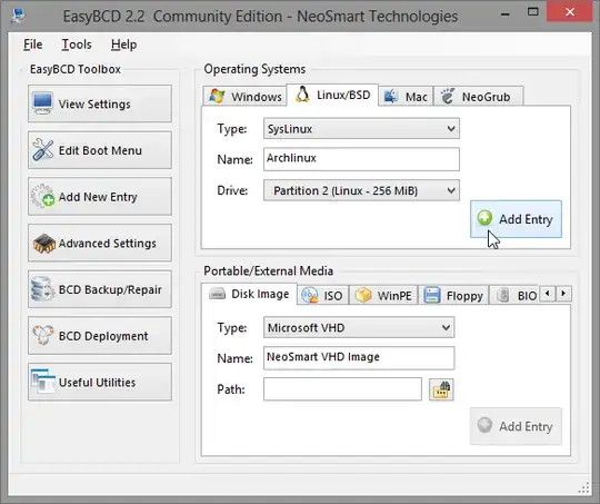

Now, I like to use EasyBCD (free for personal usage) to deal with the Windows bootloader, but anything that I do with it can be accomplished without with the proper bcdboot, bcdedit, etc. commands.
  1. Open EasyBCD and go to the "Add New Entry" section and the "Linux/BSD" tab.
  2. Select the bootloader you have for your Linux distribution. In case of GRUB2 there's an autoselect mode which will select the appropriate partition for you, for Syslinux for example you have to compulsory select the partition where it is installed.
  3. Name the entry, the name you put there is the one that will appear in the Windows bootloader.
  4. Select the partition where your bootloader resides or autoselect if that option is possible. In the end you should end up with something like this:
  5. Click in "Add entry" and you'll receive the result in the bottom left part of the program:
  6. Now you have to restore the Windows bootloader as the default one, for that go to the "BCD Deployment" section, there select to write the Vista/7 bootloader in the MBR (which by the way is the same as for Windows 8):
  7. After that you're all set, you'll receive a similar confirmation as before. When booting up you'll see the boot menu prompting you to select one of them:

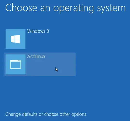

Why I'm not sure I'd recommend doing this using the new graphical boot menu in Windows 8:
Essentially because the way it works is different than with the textual menu (default for Windows 7). In Windows 7 (or Vista) you're first presented with the boot menu and then it starts to load whatever you choose to, in the new graphical menu it first loads some stuff (= takes time) and then presents you with the boot menu. If you don't select to load Windows 8, it reboots the machine and starts to load whatever you selected which in this case is the Linux bootloader.
I find waiting to load some stuff just to discard it and reboot unnecessary if I just want to boot another OS; but it's my personal opinion on the matter, there's no problem whatsoever by loading Linux, or any other OS in this manner.
Anyway, there are different ways to use the textual boot menu instead in Windows 8, if you're interested check this answer out.
Source from : Xandy

Many forms of UEFI are out there and every manufacturer has its own solution. For example, I use Lenovo Y580 laptop and it doesn't have an option to boot from a DVD. So I will present a universal solution (and the fastest one) - install Ubuntu from USB. To properly make a bootable USB you need to download RUFUS. Do not use Wubi (nor UNetbootin...) because to my knowledge, at the present time, they do not support all these technologies (UEFI, GPT...), so the only option that I know of and have tested successfully is Rufus. It is a simple and effective program. In case you are wondering whether you have GPT partition table or MBR, you can check this by opening Windows Disk Management, right-click on Disk0 and select properties/volumes tab/partition style.
As for other UEFI options, as Luis Alvarado mentioned, you might want to try installing Ubuntu with Secure boot enabled. If boot fails then disable it. You should also disable fast boot (if available) and enable USB boot as well. If everything else fails then you should install Ubuntu in Legacy mode. Afterwards, use Boot-Repair tool to adjust Grub2 (it is an automated process). Then you can boot both OS from the same UEFI mode.
For some reason (probably a bug) my UEFI doesn't recognize the bootable USB at first entrance, so I have to boot twice into UEFI to change the boot device order.
As for the installation of Ubuntu itself, if you are new to this procedure, take my advice and you should see some explanatory video, for it is reported that some people had some issues when it comes to selecting the installation type. Of course, if you want Windows alongside Ubuntu, you should choose the "Something else" option, it's the last one – not the first, as shown on the screenshot!
Installation Type
Then select the partition for Ubuntu (whether to choose sda1, sda2, sdb1, sdb2...). The interface is different from Windows installation.There is a good post explaining this matter, but read it whole especially the OEM chapter. You must know why it is better to have separate root and home partitions, do you need swap area concerning SSD drives, etc.
Choose partition
Now Luis Alvarado already mentioned that you should have free space, for your Ubuntu partition, formed and ready before you start the Ubuntu installation. It is for the best, and you can easily do it from Windows "Disk Management". Note that this partition must be an active type partition.

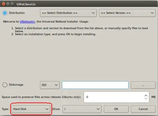

With Ubuntu, you really can't go wrong with preparing a live install media by using unetbootin. With unetbootin you can use your Hard Disk or an external flash drive for the installation media.
1. installing on A Hard Disk
In the unetbootin window, choose Hard Disk from the drop down menu. Choose the Ubuntu ISO you want to install from and perform the rest of the steps needed to finalize the installation. The next time you boot up your system, you will see the unetbootin boot menu rather than booting into Windows.
HDD
2. installing on a USB flash drive
This is fairly straightforward but you can't use this method to install OSes to UEFI-GPT systems unless you install the OS to run in legacy mode. To install to systems that use the BIOS firmware standard, this is the best and most practical method. The variation from the method depicted above is that you have to choose USB Drive in the drop-down menu in the unetbootin window.
USB
endrias
