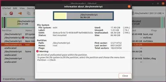

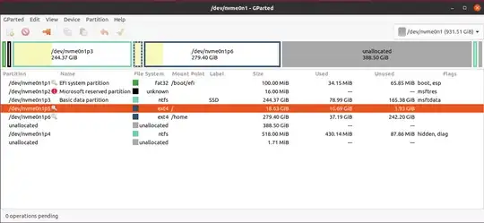

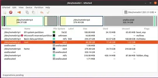

I'm about to run out of space on my root partition and I have plenty of unallocated space. When creating the partitions, I thought I had enough space, but it turned out that I didn't. On the information I found it says that it is quite risky, so I want to make sure to do it properly. How should I resize the root partition? (I have a dual boot with windows)
Here is the situation:
enter image description here enter image description here enter image description here

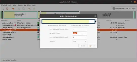

Update: I followed your instructions and an error occured:

  • resize the left side of /dev/nvme0n1p6 to the right by approximately 70G
  • resize the right side of /dev/nvme0n1p5 all the way to the right
  • click the Apply icon
When done, quit gparted and reboot.
