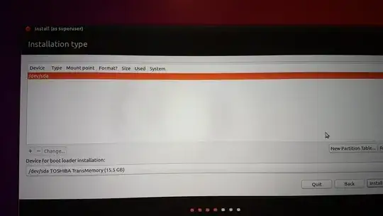

I got a new Dell xps15 with Windows 10 and I am trying to install Ubuntu 16 on dual boot.
I am following this guide: http://www.everydaylinuxuser.com/2015/11/how-to-install-ubuntu-linux-alongside.html
This is what I did:
  1. Download Ubuntu iso and create the usb pen boot drive
  2. Shrink the main C: drive, now I have 229 Gb not allocated
  3. Restart and boot from usb.
The problem is that when I arrive to the "Installation type" window, there is not the option "Install along side window" but only this: /dev/sda (see picture below).
If I click "install" an error occurs: what can I do?

The easist possibility that the Ubuntu installer thinks there's something wrong with your Windows NTFS file system, and as such doesn't detect that they're a valid install choice for "along side".
If the NTFS drives are mounting as read-only, its probably because Ubuntu thinks their filesystems are unclean, probably due to hibernation, or a damaged file system. Do this...
In Windows...
  • boot into Windows
  • open the Power control panel
  • choose change what the power buttons do
  • choose change options that are unavailable
  • uncheck fast startup
  • close the Power control panel
  • open an administrative command prompt window
  • type powercfg /h off
  • type chkdsk /f c:
  • approve to run chkdsk at next reboot
  • reboot into Windows to let chkdsk run on drive C:
Then retry installing Ubuntu with the "along side" installation choice.
The other possibility is that your BIOS is set up for your disk as RAID, and the Ubuntu installer won't install to that.
Make sure to have a backup of your important Windows files!
You've got a single SSD/HDD set up in RAID mode, and the Ubuntu installer won't recognize your SSD/HDD until you switch your disk setting in the BIOS from RAID to AHCI.
Making that switch comes with some problems though, as Windows will no longer boot. Looking at this article https://samnicholls.net/2016/01/14/how-to-switch-sata-raid-to-ahci-windows-10-xps-13/ will show you how to make the change without having to reinstall Windows. (You can also see http://triplescomputers.com/blog/uncategorized/solution-switch-windows-10-from-raidide-to-ahci-operation/).
Boot to Windows with your current SATA controller configuration
Open Device Manager
Expand Storage Controllers and identify the Intel SATA RAID Controller
View properties of the identified controller
On the Driver tab, click the Update driver… button
Browse my computer…, Let me pick…
Uncheck Show compatible hardware
Select Microsoft as manufacturer
Select Microsoft Storage Spaces Controller as model3
Accept that Windows cannot confirm that this driver is compatible
Save changes, reboot to BIOS and change RAID SATA Controller to AHCI
Save changes and reboot normally, hopefully to Windows
Now you should be able to install Ubuntu in a dual-boot configuration.
