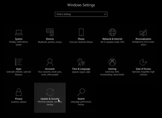

Go to Settings -> Update and Security:
Recovery -> (Advanced startup) Restart now:
