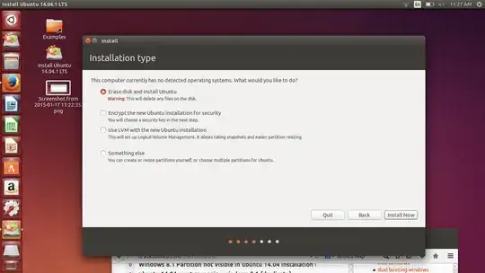

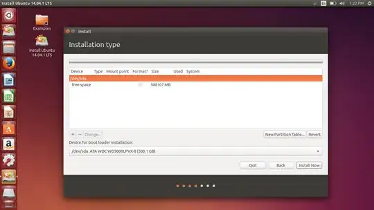

I have tried installing Ubuntu 14.04 64-bit alongside Windows 8.1 64-bit for several hours, but i can't seem to find the solution to actually installing it without removing my Windows 8.1 from the hard drive. The problem is that Ubuntu doesn't seem to recognize my Windows 8.1 on the hard drive and it show the whole hard drive as it is empty. I have both tried installing it with CD and USB-drive. The outcome is still the same.

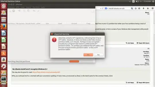

GParted error message :
