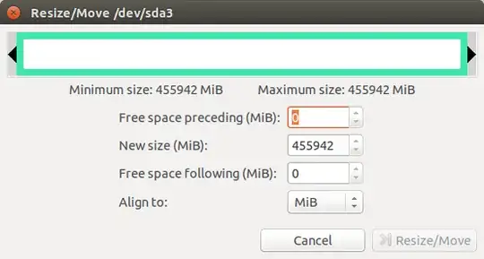

Edit: On GParted I selected sda3 and tried to change the size of it but it doesn't work. I tried to drag it back and forth but nothing happens? Sda3 shows white for the drive.

Can I not make a partition for Ubuntu at all, seeing that I can't change the "Windows" partition?

Firstly make sure you have your a Windows 10 disk or "repair" option in your PC so that you can fix windows in the even that something goes wrong. Also backup any data you can't afford to lose before you ever do any disk operations.
Make a Live CD or USB and boot using that. Select "Try Ubuntu" and run GParted as you suggest and resize your NTFS partition to be smaller by the amount you want Ubuntu to use. The NTFS resize tools have been used a lot and I resize my drives with them often. As long as you don't interrupt the process it will resize it. Also take note that you should "shrink" it from the right side leaving you free space at the "end" of the disk.
What usually messes people up is doing multiple things they don't understand and then they don't know what failed. After having just done the simple resize you now have "unallocated" or "free" space.
At this point you can reboot and you should still have access to Windows since all you have done is created free space on your drive and not changed the layout of your disk partitions.
Once you have verified everything is still working as expected boot the live CD or USB back and select the "Install Ubuntu" option. When it gets to the step for selecting partitions you should have an option allowing you to use the free space you created earlier. Ubuntu will create 2 partitions within this free space.
When the Ubuntu installer is finished it will ask you to install a new manager called "grub" which you should select Yes and allow. This will find your Windows 10 installation and put it into a menu that you will see when the computer is booting up - the "grub" menu. If you do not install grub Windows 10 will boot by default and not provide the option to select Linux.
I did it maybe 1000 times, most of the times this is very easy and quick process.
I won't go much in detail, as you can find tons of tutorials from internet. Keywords: "How to dual-boot"
Safest shrinking option is inside Windows, other ways can work too. Login to Windows, open disk manager, shrink your disk, reboot.
About custom partition page: Right now have 1 MB free space, so you can't install. Do the shrinking, and then create one ext4 partition that mounts to / with minimum size of 40GB. And one partition that mounts to swap area with size of your RAM.
