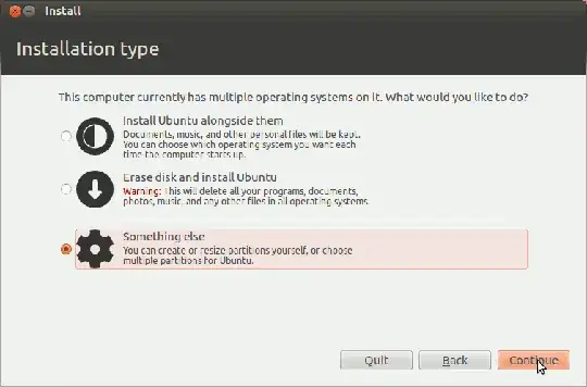

At the screen, choose 'Install Ubuntu'.
Now choose 'Install Ubuntu alongside Windows 8'.

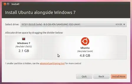

If this screen comes up, choose how much memory you want Ubuntu to have.

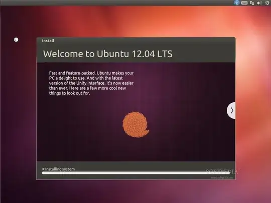

It may come to this screen.
