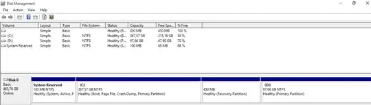

I'm facing some difficulties installing Ubuntu in dual-boot with 10.
This is my actual partition schematic:
Volume manager screenshot
How can I install Linux?

There are a lot of ways to install Ubuntu along side windows.Please do a brief search on google for it. But you can refer below points to achieve so
  • Choose one drive where you want to install Ubuntu ( Since Ubuntu doesn't require much of space , you can choose the drive which is of the minimum space.20 to 30 GB will be enough.
  • Since Ubuntu can read NTFS file system, you won't require to format any other drive.You can always store and access your data from Ubuntu in any windows ( NTFS) drive
  • The drive that you will choose for Ubuntu installation withh be converted into ext* format ,which is not readable by Windows.
  • Once to do the installation, on restart you will be welcomed by Ubuntu boot load screen since it has high priority , there you can choose for your desire OS.
