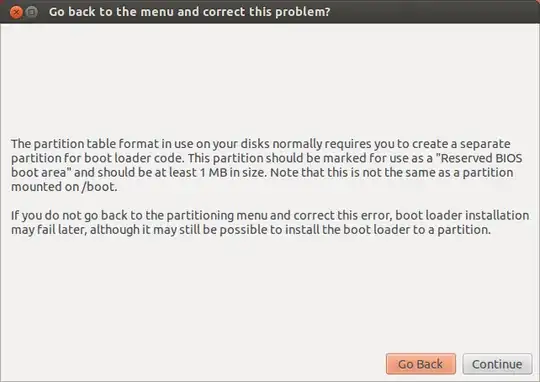

I've just bought a new Acer computer and have been trying to install Ubuntu it. I've been following the steps as I did on my other computer and get this error when selection the option: "Something else".
I've selected the partition and clicked continue and got this error:
What does this message mean and if I keep going what would happen to my computer. Any help would be awesome.

You should do what it says; Go Back & check your installation settings. Have you allocated enough swap space for the install?

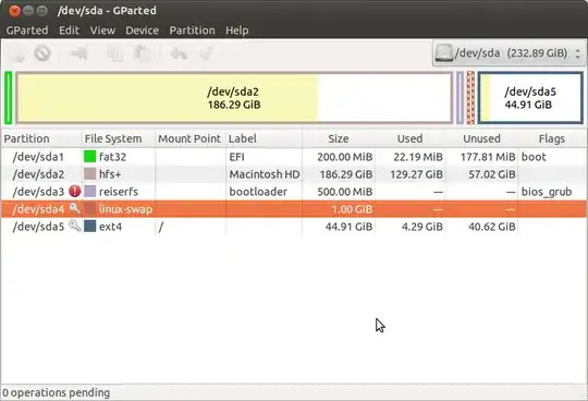

In order to fix this issue I needed to create an extra partition. Follow the steps below. The first one should be done in OSX's Disk Utility and the rest inside GParted after selecting "Try Ubuntu."
  1. Make sure to have already resized your "Macintosh HD" partition so that you have room for the new partitions (~50 GiB is what I chose). Note: This is the only step you should be doing in an OSX-native program like Disk Utility and not within Ubuntu.
  2. Create a new partition called "booatloader" with file system ReiserFS. I made this partition 500 MiB. (I'm not exactly sure if the file system or size matters)
  3. Create a new linux-swap partition that's about 1 GiB. I called this one "swap".
  4. Create an ext4 partition called "primary" using the rest of your unallocated space.
After following the instructions above, GParted should look similar to the following image. Keep in mind that I took this after installation. The labels for my linux-swap and ext4 partitions disappeared and the key/exclamation icons were added after installation by Ubuntu. Also, no need to set a bios_grub flag for the ResiserFS partition, this was also automatically added post- (or during-) installation. GParted

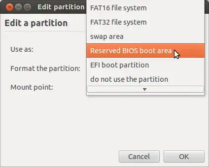

  3. You'll now arrive at a window that lists all the partitions you have. Identify the "bootloader" partition (if the labels don't show, identify it by the device, type, or size columns) and double click on it.
  4. A window that says "Edit partition" should popup. Select the option field next to "Use as:" and click on the value that says "Reserved BIOS boot area" (figure below). Press "OK." Select "Reserved BIOS boot area"
  5. Identify the ext4 partition you just created and bring up the "Edit partition" window.
  6. Set the "Use as:" value to "Ext4 journaling file system," check the format option. Make sure to also set the mount field to /. Press "OK."

The SWAP should be as large as your RAM in a desktop system, to prevent system freezes and avoid uncommon and "uncomfortable" configurations.
You should also leave a small space for the "BIOS" boot area of 2 mb: don't worry you are not loosing space, because there is always some free space on the HD after any OS installation.
