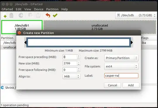

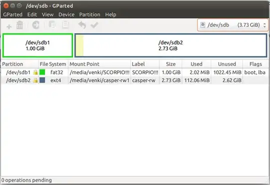

  • First, partition your USB device into two partitions from your Windows OS. Keep at least a 1 GB or so partition for the Ubuntu installation files(make this a FAT32 partition). Make another ext4(or ext2 or ext3) partition of the remaining space and remember to name it casper-rw(It is highly essential to name it so.). Use a GParted Live CD for this purpose(or any other partitioning software you like. I am recommending this because it worked for me). I am providing a few screen shots below(but these are not of the Gparted Live CD, I used):-
(Creating the FAT32 partition mentioned below) enter image description here
(Creating the casper-rw(ext4) partition) enter image description here
(How it looks after partitioning) enter image description here

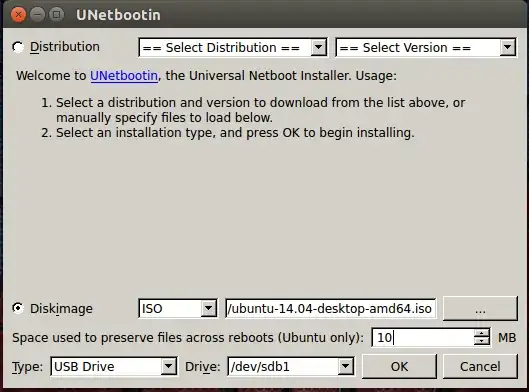

  • Now put the installation files into the FAT32 partition. For this you must use UNetbootin. See the screen shot below of UNetbootin :-
Carefully note what all I have selected and select exactly the same in your UNetbootin too(except for selecting Ubuntu 14.04 64-bit image! You have to select your 12.04 image). Also compare this image with the image before it. I have selected /dev/sdb1 since that is my FAT32 partition. You should select the FAT32 partition, accordingly in your PC.

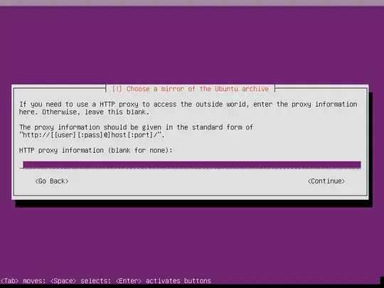

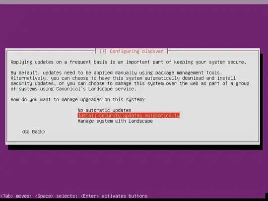

Since you have a problem with the GUI installer you must try the Text based installer provided by the Ubuntu minimal CD. But, most probably, after the install you will have the "low graphics issue" in your Ubuntu. To solve it just refer to the answers in this question. Now I will show you how to install Ubuntu with the Text based installer. Remember that a decent working internet connection is compulsory for this.
Installing Ubuntu with the Text based installer(MinimalCD) :
  1. Download the minimal CD for your Ubuntu version(12.04 LTS) from here.
  2. Then burn the mini.iso file you would have got from the download onto a CD.(This is preferable as some of the images don't work properly with a USB device.)
  3. Now Boot from your CD and you will see these on your screen. Just follow the instruction given above each screen shot.
Select 'Install' here.

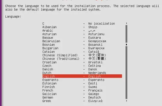

Select the language you prefer.

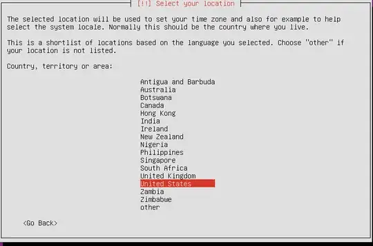

Select your country.

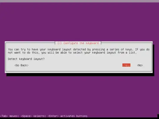

Now you could choose no and set your keyboard later. If you choose yes, it will ask you a few questions in order to detect your language.

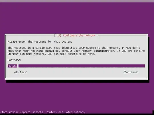

Type in a host name.

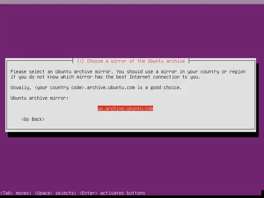

Here it is recommended to choose your own country. If not, then the closest mirror to your country so you could have a faster download speed. You'd be grabbing a few packages from there(Its like Debian net install).
I won't use proxies for now. If you want to use proxy, you could.

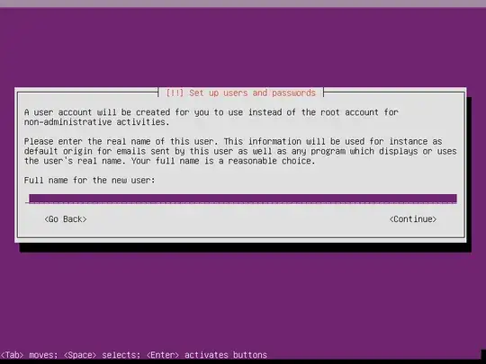

Give a Name, User name & password and it will later ask you to set the time.

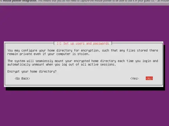

I choose no here to keep it simple

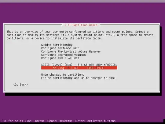

Now you need to pay attention because it is partitioning time! I highlighted Virtual box entire disk. If you want to choose the entire disk you just hit Enter else if you want to dual boot and:
  • If you have another Linux distro, you could use Gparted. I prefer the LiveCD of Gparted, simply because everything is unmounted. So you partition your disk and then you run Ubuntu installer and follow the steps below.
  • If you're on Windows OS then you could use the partition manager available in it. Press the Windows button and type 'partition' in the search box of the 'Start' menu that appears. The partition manager will show up. The complete guide you must follow for this purpose is here.
Now that you have a free partition, you must highlight it and press Enter. Note that I don't configure LVM on my computer to keep it simple but I would definitely do so on a server. I won't talk much about it in this answer, so just hit Enter for now.
Choose Finish partitioning and write changes to disk to let it do the partitioning automatically instead of doing it manually(i.e letting the home partition be on a different partition and so on. If you wish to you could do it manually too).

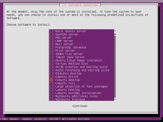

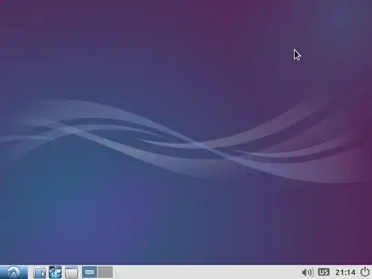

When it's done downloading, you will see the menu shown below. I recommend choosing only the Desktop Environment(DE) you want and install services later. You select an option by pressing Space and then Continue(I chose Lubuntu-minimal for a demo).
