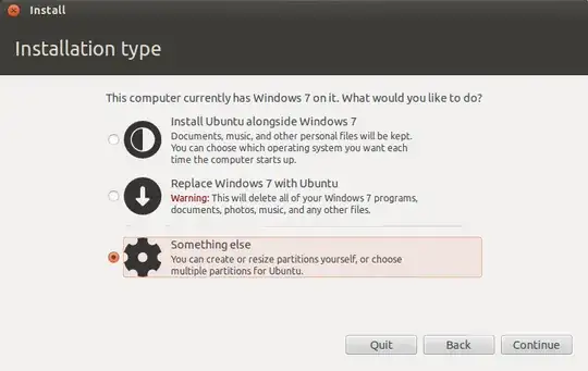

Now start the Ubuntu Installator, when it prompts you for the installation type you should choose Something Else, the last option.
Installation type
