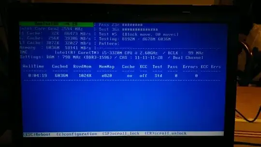

memtest
memtest passes without errors. It reports Memory: 6036M but seems to test the full memory (Testing: 8192M - 8678M).screenshot memtest.
I don't know anything about memetest, so I don't know whether that's normal.

Memtest seems to do that, reports what "block size" it's currently testing, even if the installed memory doesn't go that high. But it does appear to report 6036 megs...
And free only sees 6,000,984k, or 6GB too.
If your BIOS also reports only 6GB, then it looks like something's happened to your other 2GB or ram... Maybe it's come loose & re-seating it could help, or maybe it's gone or failed?
